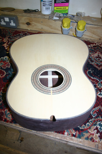

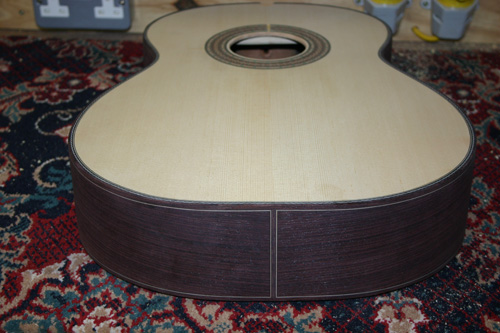

Ok so its not my first guitar, but it is the first classical I ever made.
Thought I would share a few pics, it is loosely based on a Fleta, with some bits of Torres thrown in for good measure.

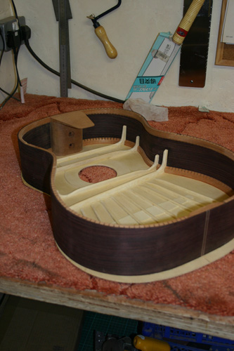

Interesting bracing and a bolt on neck interesting very interesting

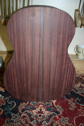

Yes it is EIRW Back and sides with the off cut from the sides used as binding. THE EIRW is the most beautiful set I have ever seen my customer bought it about 30 years ago with the intention of making this guitar himself (he is a Cabinet Maker). He is unfortunately now Terminally ill with about 6 to 12 Months to live, so his Son and him asked me to build it.
It has a 15' Radius side to side on the back, and 28' in the lower bout on the top, then Flat in the upper bout.

The Neck Joint is a normal Bolt On using Cross Dowels, The Neck will be set up flat and then the fingerboard will be tapered from the nut to the rosette end.

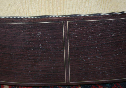

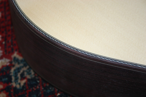

Looking good Russel! I like the rope purfling, did you make it?

No I didn't make the rope, I got it from Karin Rost in Germany http://www.karin-rost.com/ they make some really nice stuff and are very friendly to deal with.

Wow, Russ, that's one gorgeous guitar. Really like the purfling. I've been meaning to order some from them. Do you have a stock # handy?

The Stock Number is S175, for the Rope.

That's beautiful Russell! I really like that top rope purfling. Very classy.

The binding and purfling combo and workmanship really got my attention!

Very nice looking Russell. Also very cool that you have the Spanish foot and are bolting the neck on. I think that is a very intellegent way to go about attaching any kind of neck, classicals included, and it speaks volumes for your willingness to do the unconventional.
The braces just shine and the entire box looks sensitive. I bet it is going to sound wonderful.

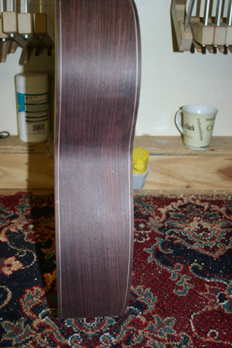

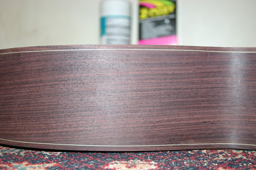

That's beautiful. I love self-bound guitars.
Not speaking of those rare guitars that actually put their own bindings on themsleves, but those guitars that use side cut-offs for binding. If you do have a guitar that actually binds itself, will you take pictures of that, please?

I love the bookmatch on the binding (looks bookmatched anyway)

Thats something I would like to see, I did do a top replacement where I dropped the top in leaving the bindings in place, kind of self binding.
Thanks, The Fleta design didn't have the heel, but I though it seemed appropriate.
